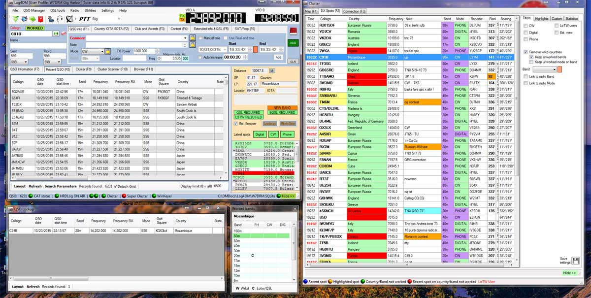

Hi
on the QSO information page (f7) can i have the DX cluster showing there instead of the map please..???
This will give access to the cluster and to the QSO Lookup panel at the same time
Thank you

Sorry but that not possible, you do however have the small cluster to the right of the map which you can drag bigger

You can also open the Cluster window by clicking on the first tool icon on the left side of the tool strip. You can then size that window as you like and have the QSO information info at the same time.
Or, you can detach the QSO info grid, and the Worked grid and have them displayed seperately, then display the Cluster (F9) tab and view all information at the same time.
Screen shot of both solutions.
I hope this helps!
