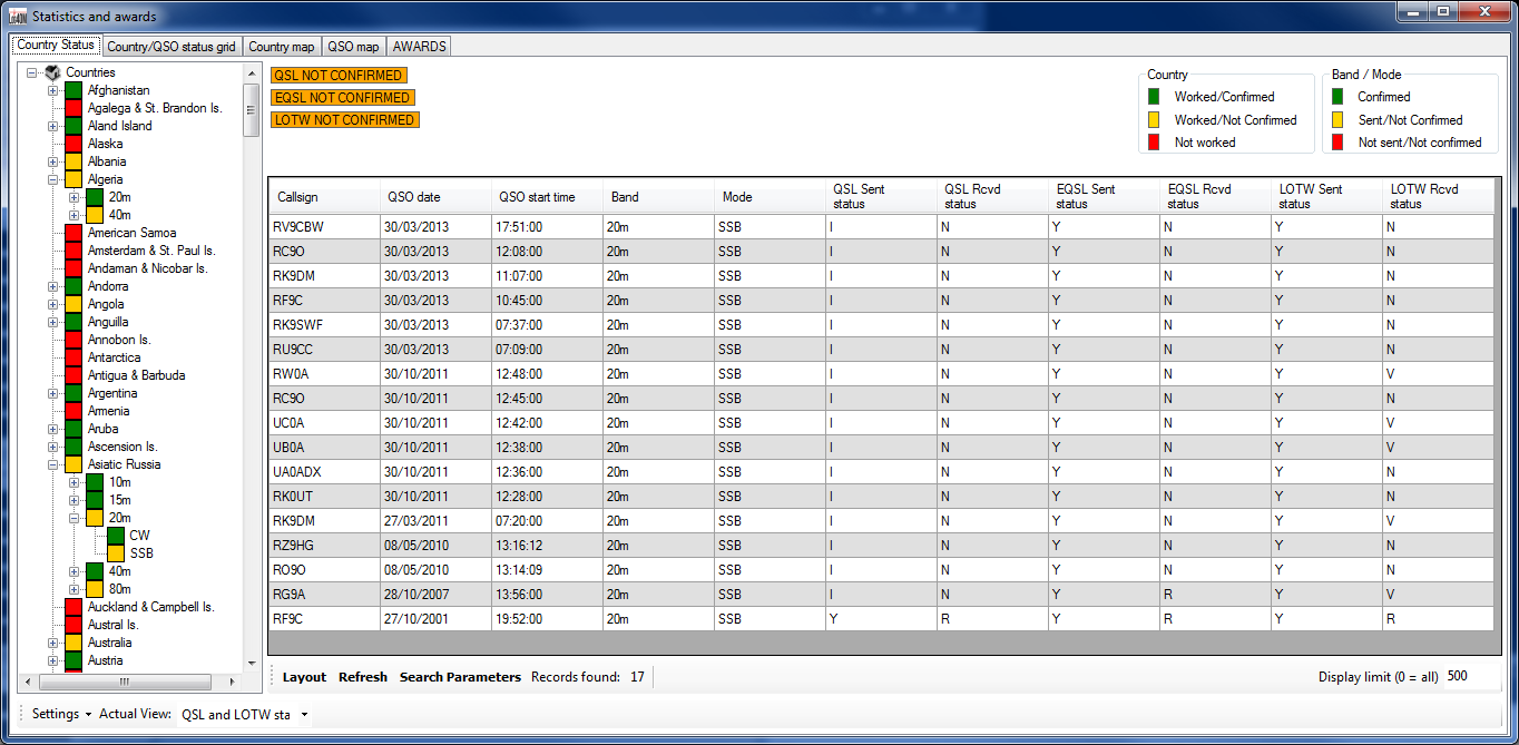

Likely mis-understanding/mis-intepretation on my part but I'd appreciate a clarification; see pic below/attached;
Look at Asiatic Russia, 20m SSB, there are 5 QSOs that are verified in LOTW but the system is indicating "Worked/Not Confirmed" for 20m SSB for that country and in the top LH corner of the QSO detail panel LOTW NOT CONFIRMED is orange when I'd expect it to be green..?

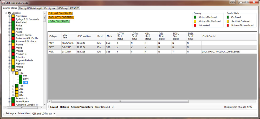

Thanks Chuck. My bad. Wrong mode. Ok, I switched over to the "QSL and LOTW status" and found a similar situation to BR's, where a band/mode had LotW Verification, but no QSL confirmed. My grid seems to update correctly. My results are below.
However, I do see that something is amiss in my Country/Band/Mode hierarchy display on the left panel, in that for 15m the band box is green, but for 10m, the band square is yellow, even though I have all modes verified in both bands. ??
There seems to be something amiss in the program or data which is causing these irregular displays. Lele??
Doug - W7DRM
Doug - NN7D
Gig Harbor, WA, USA
Re: Statistics and awards - Worked/Not Confirmed but LOTW verified
the tree works that way:
on top level, unworked (or unconfirmed in qsl/lotw/eqsl...,following the settings) reports RED
At BAND level, green means ALL sub items are GREEN.
YELLOW means that at least one of the sub items is not green
This is intended to view, at a first level, if something is needed in that band. If band is green, everything below is green without needs to go in deep.
In EI4HQ sample, asiatic russia is YELLOW, because at least one band below is YELLOW.
And 20m is Yellow because SSB is not confirmed
When you get a confirmation (for the current view settings) for 20m ssb the 20m goes green, then 10, 15, 20, 40m bands will be green, but asiatic russia still stays Yellow, because a confirmation is needed on 80m. If you dig into 80m you will see at least one mode where confirmation is still missing.
The same view, based on WORKED instead of confirmed, uses another approach and graphic, because there is no sense to mark Yellow bands or modes never worked, so in W7DRM screenshot the top level color is green or red, means worked or not. Other informations are pretty informative. In that case there is no sense to mark Yellow a band where you never transmit or a mode that you never use.
The confirmation view, instead, has a different approach, because is focused on confirmations related to QSO made.

Understand what you say about yellow if any items below are yellow, but in EI4HQ's first example, why is 20m/SSB yellow and not green, when 20m SSB is clearly confirmed with LotW status of V??
And in my last example with "QSL and LOTW Status" selected, why is Aruba/10m yellow and not green, when all modes below it are green and confirmed?
Thanks!
Doug - W7DRM
Doug - NN7D
Gig Harbor, WA, USA
EI4HQ
Posts: 38
Joined: 02 Nov 2013, 19:39
Location: Cobh IO51uu
Post by EI4HQ »
All,
Only logic I thought might explain why the mode remains yellow is if only one of LOTW or QSL are confirmed but the confirmation check requires both to be confirmed to go green (whether it intends to do that or not is another matter) i.e.
if LOTW and QSL then GREEN
if LOTW or QSL then YELLOW
However W7DRM's recent posting seems to blow that theory out of the water; he doesn't have 10M SSB confirmed on QSL but "only" on LOTW (sorry, but you know what I mean!) - by my logic he should also be seeing 10m SSB for Aruba as orange but it's showing up as green. He's seeing a confirmation issue further up the tree...
BR
Cormac, EI4HQ
[Cobh IO51uu / UTC] NNNN++++
I'm investigating.
The supposed way to work is that confirmation should be obtained with LOTW *OR* QSL (that is the DXCC requirement)
