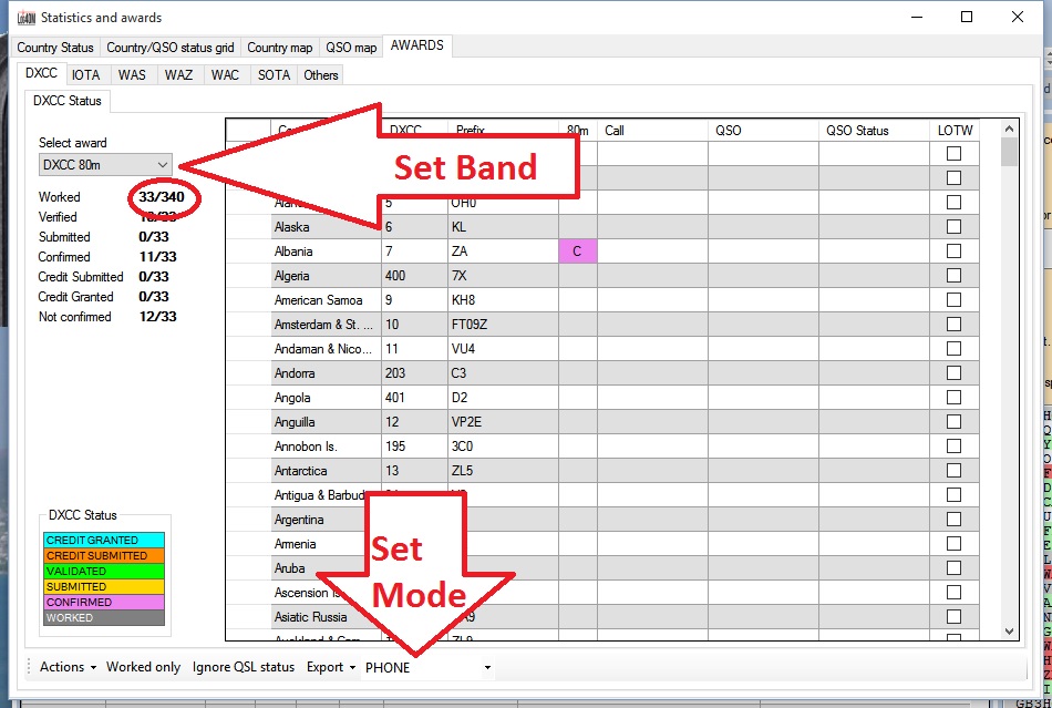

Is there an easy way to see how many DXCC I have worked and/or confirmed on 80m SSB without counting manually?
I used [Statistics and awards] Tab [Awards] but can't select a certain mode when on a specific band (or vice versa).
Why I need this? For the national DX-Honor Roll "competition"
I don't like manual counting :-(
73's, Evert PA2KW
Re: DXCC counts
Yes Evert in statistics and awards - See image below

Tnx Terry,
I feel almost ashamed.
I've been playing the whole afternoon in this [Statistics and awards] and just did not see it.
For some reason I missed that.
