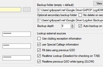

It seems the lat and lon in Cublog is incorrect, try unchecking the Clublog lookup in Options/Settings 1 and entering the call again and you will see what I mean.
Just double click on the QSO in the recent QSO window to edit the grid square

Thanks Terry. That fixed it. What file does the clublog exceptions live?
