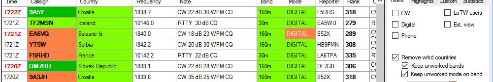

cluster filtering sometine wongly detect spot mode
have a llok at attached
CW CW spots automatically detected, are recogned as DIGITAL in LOGand mixed with real RTTY qso

You can edit the band plan for your region/Country requirements which vary greatly for 160M.

sorry I cannot find a bandplan config file, can you help me ?

The band plans for each region is located at:
C>user>app>data>roaming>LogOM
There is a band plan for each region with xml file named:
bandplan_r1, r2 and r3.
