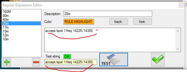

How would one make the General portion of the band only spots show ....Where would on place the info to make filter work? I have used both below and seems like I cant stop the spots from xtra parts of the band from coming in.

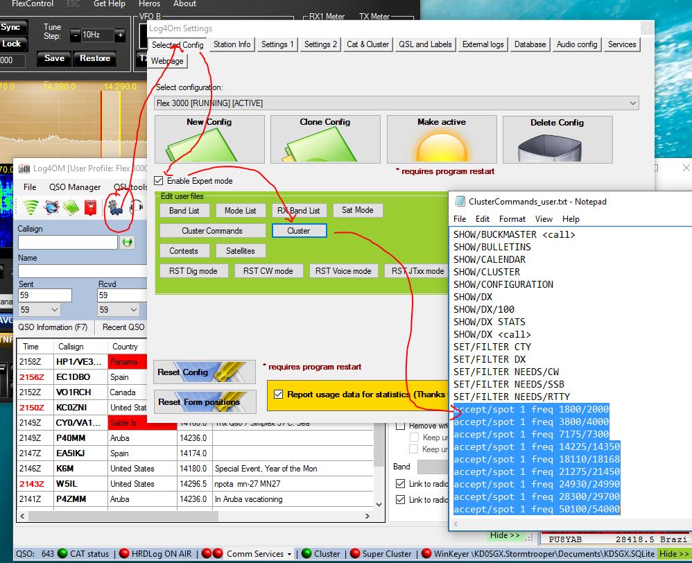

If you want to include those commands into the list of commands in Log4OM, you can edit the Cluster Commands file - ClusterCommands_user.txt to include those commands. You can access that file by going to Settings within Log4OM, Selected Config tab and clicking on the Enable Expert mode. Then click on the Cluster Commands button which will open this file for editing.

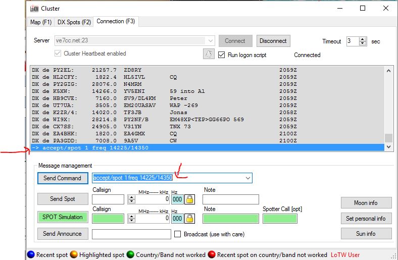

Doug,
Thank you so much !! I think this is what you are talking about?? Picture is worth like a 10000 words!!

NN7D
Posts: 816
Joined: 19 Feb 2014, 19:44
Re: cluster setup
Post by NN7D »
Mike,
One other thing, in your screen shot, you have the Cluster button annotated. That will give you a list of all the clusters. To be clear, you need to press the Cluster Commands button. It looks like you did, but the wrong button is highlighted.

KD0SGX
Posts: 31
Joined: 03 Feb 2016, 17:04
Re: cluster setup
Post by KD0SGX »
Doug,
I think I have it now, and yes you are correct. I have the wrong tab annotated. oopps. Here is how my Cluster Commands now look. We will see if it works.

Re: cluster setup
Post by NN7D »
Mike,
Please know that you are editing the cluster command file, which holds the possible commands which you can send. But they need to be sent, one at a time - each one which affects frequency for each band. It is not automatic.
