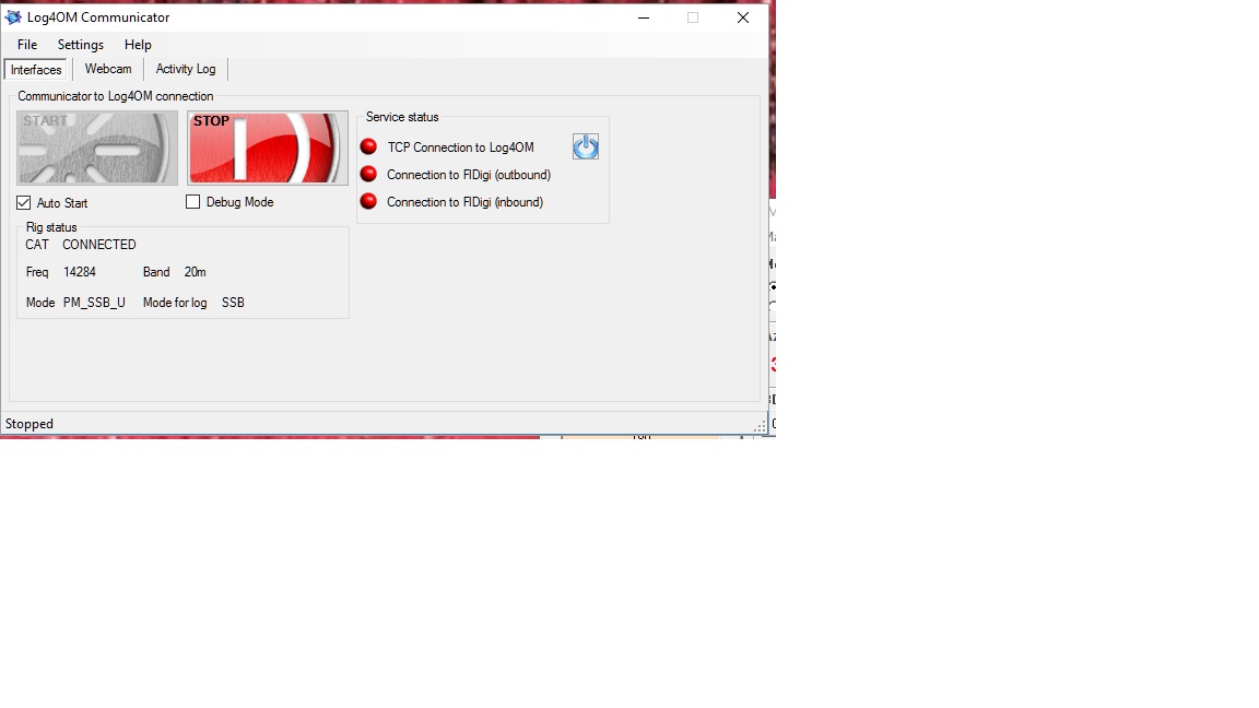

I have a problem with the Communicator program stopping.
It run fine for a few minutes then stops.
It affects PstrotatorAZ and updating the log from JTAlert.
I can restart the Communicator and JTAlert will update but will stop again.
JT65-HF HB9HQX is sending the record fine to JTAlert.
Once PstRotatorAZ stops I cannot get it to work until I reload Log4OM.

Communicator stops working
- Stopped.jpg (71.79 KiB) Viewed 2737 times

After working with this a few days and trying everything I have it working better now.
In the Communicator settings, Inbound I had enable File Monitoring. Why I don't know.
When I unchecked that box it went back to working.
If I stop the Communicator and start it back the rotor part does not work until I reload Log4OM again. That's OK.

That was probably the problem if you were trying to monitor a file type that it is not designed to monitorNA4MM wrote:After working with this a few days and trying everything I have it working better now.
