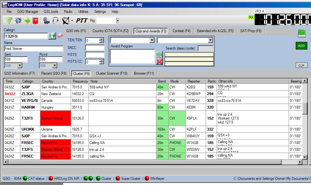

Is there a way to make "NOTE" and "Other info" contain the same information?
My issue is ( I've searched the forum):
In "Note", everything reads on one single line...This is good but it doesn't include everything that is in "Other info". (up 2 etc)
See screen capture below T32FS at 0429z
In "Other Info" all needed info is included but it goes to next line after 20 characters or so. If you change the row height of the row it immediately defaults back to narrow with the next spot.
Sometimes that's ok but on a busy day it is nearly impossible to capture what is on the 2nd, 3rd, 4th lines before it closes up again.
Help or suggestions?
Randy_KB4QQJ
Note/Other info troubles
Re: Note/Other info troubles
What I've noticed is "Other info" is collecting/accumulating the previous spotter's "Note" field.
In other words if you spot someone with 599 UK and then I spot them with 599 NC the "Other Info" field will contain:
"599 UK
599 NC"
Where your "Note" field and my "Note" field will only contain "599 UK" and "599 NC" respectively.
Is that how it's meant to be?
"599 UK
599 NC"

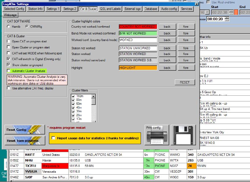

Try setting the cluster spots to ungrouped in options/cat & cluster
Thanks Terry and Daniele,
i have it set to "Show cluster ungrouped" under "settings/options/CAT&Cluster"
Is there somewhere else I'm missing?
Randy_KB4QQJ
Randy_KB4QQJ

No thats it, now each spot will be displayed separately and only the notes for that spot will be displayed

Terry,G4POP wrote:No thats it, now each spot will be displayed separately and only the notes for that spot will be displayed
That's how I've had it set all along and it still shows multiple posts in "Other info". That's what the screen shot was for to show it still shows multiple posts set to show ungrouped.
Not a real problem for me just an observation.
Randy
- Posts: 11571
OK that is a bug - The latest spot of multiple spots shows the notes for all older spots even when ungrouped
Issue reported to Lele.
Thank you for identifying this bug
