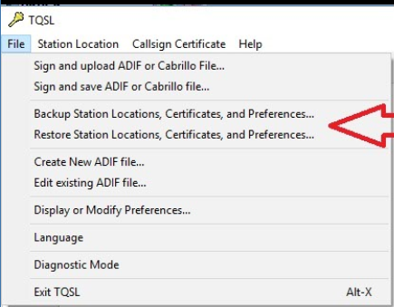

Backing up your LoTWs Call Sign Certificates and Station Locations is importent.
It will save you from a lots of hassel, When you have hardisk crash or moving to another pc etc :-)
http://www.arrl.org/files/file/LoTW%20I ... mputer.pdf
