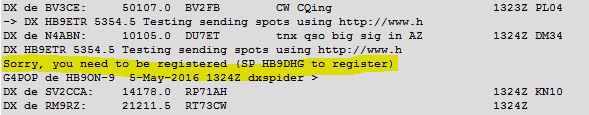

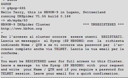

I tried http://www.hb9on.org:8000/ and because I am not registered I receive this message return in the raw cluster data
Then when sending a spot this
So you must register with HB9ON even if you have registered with another DX Spider cluster in the past
