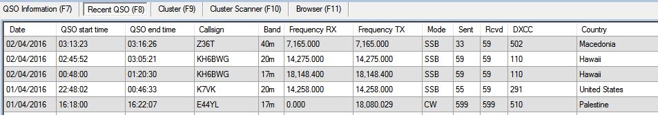

You could of course display the RX frequency in your recent QSO list etc if you wish to?
