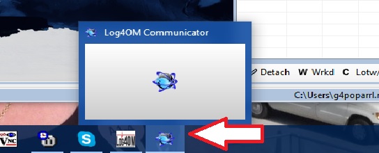

I'm integrating Log4OM with Fldigi, the online Youtube video looks like it shows how to configure them to work together,
How do I bring up the communicator like in the video?
I'm presuming that Fldigi does not need to be connected to the rig CAT as it looks like its all going to work from within Log4OM?
Cheers
Bill G4CFP
Posts: 11593
Re: Communicator
bbones wrote:I'm integrating Log4OM with Fldigi, the online Youtube video looks like it shows how to configure them to work together,
Click on the communicator icon at the bottom of your screen!
No FLDigi does not need a CAT connection you should disable all CAT controls in the FLDigi rig config window except XML/RPC
This is covered extensively in our user guide
