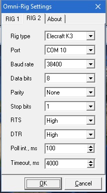

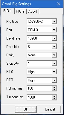

Omnirig does not care what baud rate you use it on see my set ups below, however if your using the TS590 with a direct USB connection I suggest you reduce the Kenwood baud rate to 19200 because the Kenwood USB drivers are not to goodVE4DXR wrote:Hi Terry,

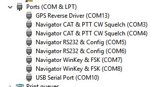

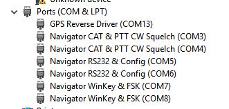

The best way to find the com port number for a specific connection is to watch the device manager while you plug the radio's USB cable in and then remove it, see my example below
This is the device manager without my radio connected - NOTICE THAT THERE IS NO COM 10
Now the image below after I reconnect the radio's USB lead - COM 10 IS NOW LISTED - ERGO THE RADIO IS CONNECTED TO COM 10
