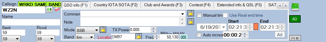

Let me give this a go...this is the entry field with a grid in the locator field
After adding to the log this is what the actual log entry looks like (missing the grid)
to make the grid actually show up in the log I have to edit the entry and place it in the locator field in the edit window and then it is fine...just can't figure out why it won't show up when entered the first time.
- entry.PNG (26.98 KiB) Viewed 5104 times

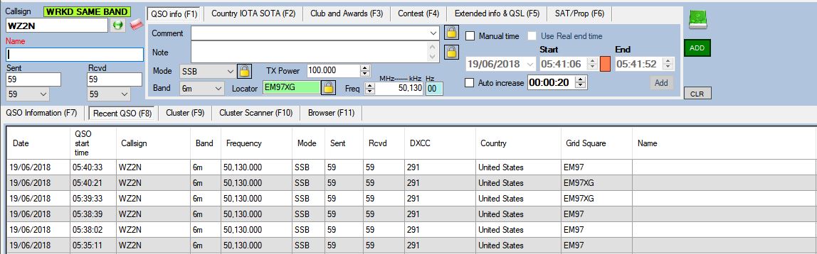

I have tried this with many different combinations, e.g. no lookups of any kind, no QRZ look up but others enabled, and I cant emulate your issue, see screen shot after just normal log entries, no editing required.
I need some extra information.
1. What version of windows are you using?
2. What version of Log4OM is installed?
3. Does the issue persist if you enter a six digit grid square?
