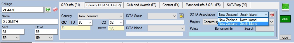

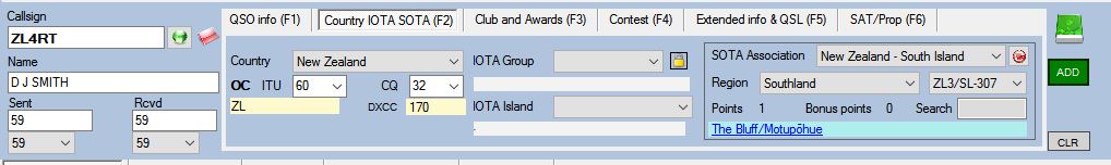

Not quiet sure what your doing wrong Steve but I just did a fresh download of the SOTA databases and all worked fine for me as shown below.
The file is attached to this post try saving it to your C:\Users\YOUR USER NAME\AppData\Roaming\LogOM folder and let it overwrite the original and try again

I am sorry to be a pain, and many thanks for your help, but I have downloaded the file you gave me and saved it to where you said, overwriting the old file.
For some reason I am still not seeing the South Island as per you jpg.
