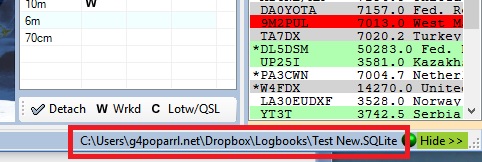

4. Locate the database file on the old computer either by referring to the path shown at the lower right corner of the Log4OM window (See screen shot below) or by searching for the SQLITE file e.g. Your call.sqlite or *.sqlite
