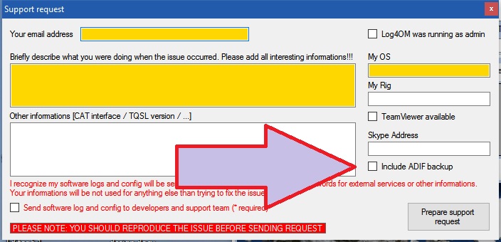

1. Enable 'Trace mode' in Help/Debug mode
2. Refresh the F8 window by using the 'Refresh' button at the bottom of the F8 window
3. Send me a 'Bug report' Help/Bug report, please be sure to check the box that says 'Include ADIF Backup' indicated in the screen shot below and include it with your report.
SEND TO ME BY EMAIL TO G4POP (AT) ARRL.NET - DO NOT POST ON THIS FORUM
