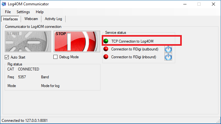

Other problem here is that the communicator from time to time lost the TCP connection to Log4OM. If that occures the qso will be not logged in Log4OM. My option is to leave the communicator window open if i use WSJT-X/JT-Alert-X so i can see the communicator is connected or not. You don´t need to start and stop the coommunicator. If the "light" shows red for the TCP connection a simple hit on the button right of the entry is all you need (before you hit the Log QSO button in WSJT-X) and the contact will be logged.
