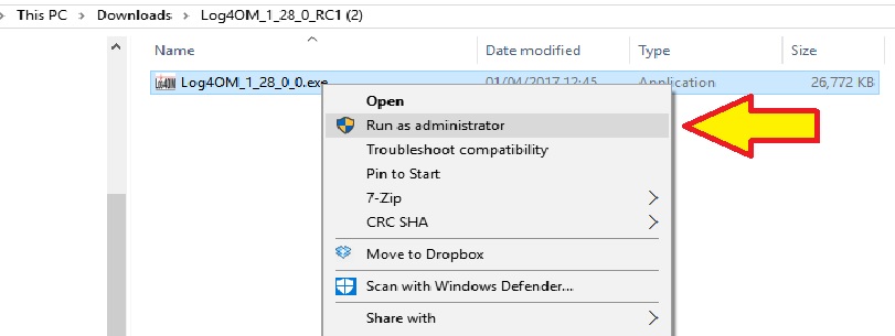

I'm quite sure to have installed and run it as run as administrator.But I'm going to remove the software and reinstall it again. I made a copy of my database.

Make sure that you install the latest version of Omnirig and no need to uninstall Log4OM just install over the top of the existing install

So, I reinstalled Log4OM and Omnirig running as Administrator ( like it was previously ). No change
