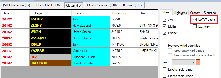

I am running version 1.28.0.0 and noticed that when the LoTW filter is checked no spots are now returned. Is anyone else having this problem?

Hi Ron,
if you mean the Box "LoTW Users" it is working fine here. If i check the Box only LotW users would be show´n in the cluster window.
B.t.w. that is only working in the F9 Window, not in the seperated small cluster on the right side.

I'm experiencing the same thing with the latest release. No stations are showing LOTW in cluster.
Re: LoTW Filter not Working
Some screenshots

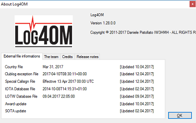

V1.28:
Make sure you have downloaded the latest LOTW user file (4/12/2017) using the "settings" drop down.
Mine was not working until I did the down load after installing 1.28.
Lele may want to check why this is.

Post by K2RAS »
That, and a program restart fixed it. Thanks,
