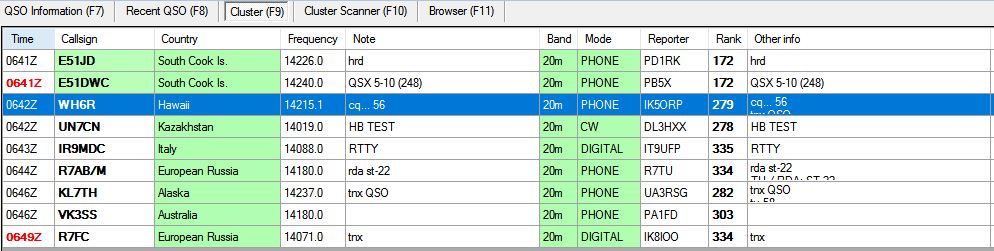

I use VE7CC (CC User) via Port 23 and occasionally run in a separate window on a 2nd monitor as I make some filter adjustments.
I'm trying to under stand why there is a repeat of information in the Cluster (F9) tab in the Note and Other info columns.
Often there will be 2, 3 or even 4 lines of the same text repeated in the Other info column. I think I read in another post where Log4OM is aggregating some data and this could be a representation of that. But ... when I'm only using VE7CC where is that other aggregated data coming from?

Not sure why the Other column mimics the Note field info, but it seems the "Other" column displays all notes from aggregated spots, while the note column displays the last note. If you right click on the note field data, a popup window will display with all the notes. I don't want to see the "Other" column either, so I just narrow its width to almost nothing by dragging the divider between the column names to collapse it. You can adjust the other column widths in a similar fashion to optimize the display to your liking.

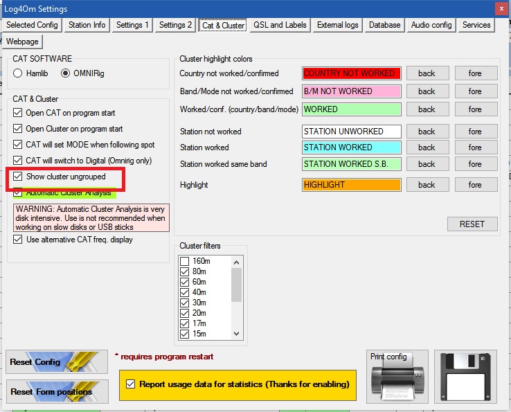

Might suit your requirements better to use the cluster ungrouped by changing option as below
BTW the multi cluster server aggregator is in version 2 not the current version
Re: Cluster (F9) Note & Other Info Columns
Terry,
Tnx. I'm probably looking right past the results, but what is the difference or explanation of grouping and ungrouping the cluster?
I've tried it both ways.
With Dougs method of viewing the cluster there are more visuals on the map view. The map view (I'll call normal operation) only shows a spot for my qth.
Again no overall worries as I'm just trying to better understand what is feeding what and what results I'm getting. Just an education on my part.

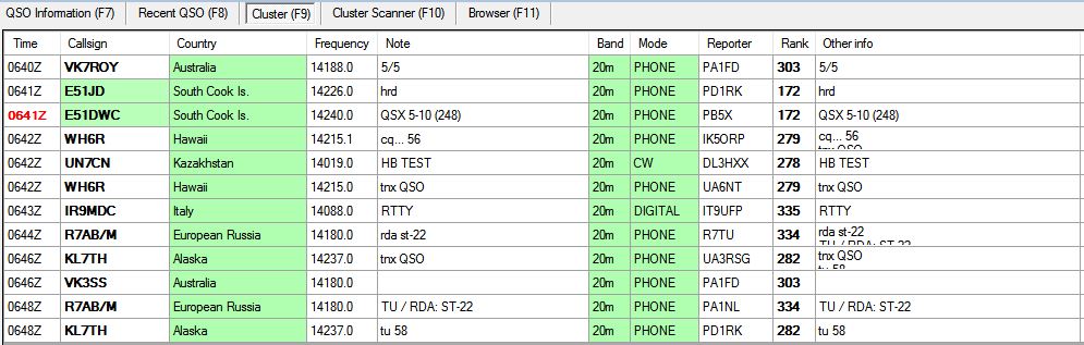

Ungrouped = Each time a spot is reported it appears in the list with only the comments and notes for that single spot
e.g
This first is 'Ungrouped' and every time WH6R is spotted on the band it is displayed separately
This is 'Grouped' - Only the latest spot for WH6R is displayed but the notes and comments are grouped in the single field for
all past spots

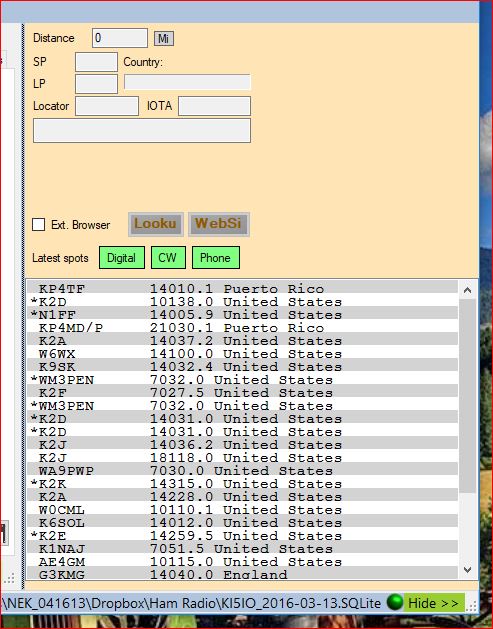

Delay in reply, but wood floor has been installed and I've had eye surgery ... now recovering quite well!!
Got VE7CC set up as Doug & Terry suggested above and I'm still working through my occasional mental blocks with setting up the filters ... especially when it comes to letting "special" callsigns to pass or not pass.
Noted that on CC User that Skimmers all have the "#" symbol noted on the DX tab.
I was trying to equate that to the "*" I'm seeing on the cluster display (far right panel) in Log4OM. That symbol does not show up in the separate window display of the Cluster Connection (F3).
Seeking clarification on that one please ??
