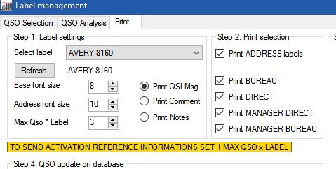

With the font sizes set up correctly as below I can find no problem with the print on 8160 stationery - See image of print out below.
