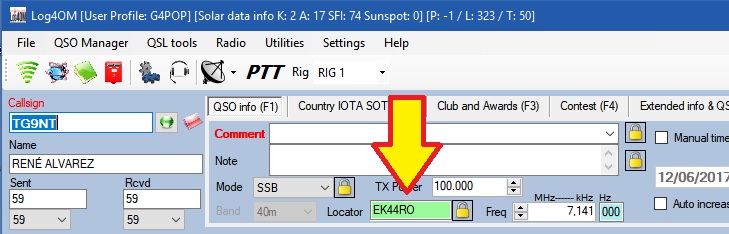

The locator in the F1 tab is for the other persons locator and is auto filled when using automatic on line lookup systems like QRZ or manually by you - see below.

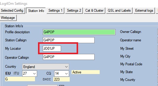

Your own locator is entered manually in the Log4OM Options/Station info tab and only requires changing if you operate away from your main location, perhaps /P or /A - See below

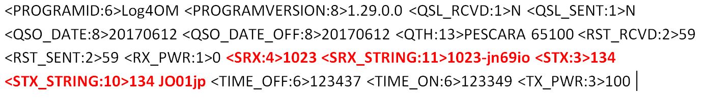

When you export the log to an ADIF file to send to the contest organiser at the end of the contest the above information will automatically be contained in the ADIF fields ...........
RST_RCVD - String --- signal report from the contacted station
RST_SENT - String --- signal report sent to the contacted station
SRX - Number --- contest QSO received serial number
SRX_STRING - String --- contest QSO received information
STX - Number --- contest QSO transmitted serial number
STX_STRING - String --- contest QSO transmitted information

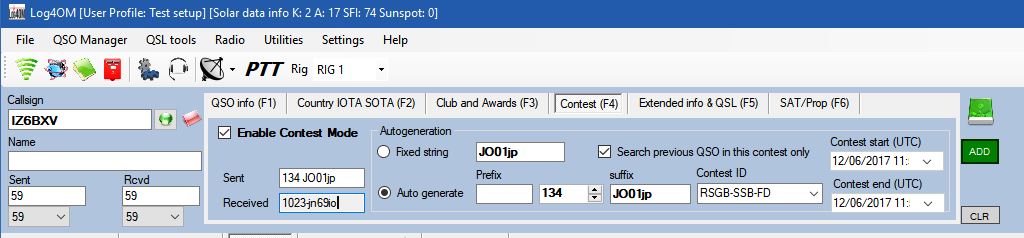

If the answer to the question above is number 1 - Then you will either need to swap between the F4 and F1 tabs during the QSO! or having inserted the locator (Exchange) in the contest 'received' field in the prescribed manner as illustrated below! then bulk edit the logbook prior to generating the ADIF file.
However if PW expect to receive the exchange (Locator) in the recognised manner using the ADIF SRX_STRING and STX-STRING fields all you need to do is add it as suggested previously into the 'Received' field in F4 as shown below.

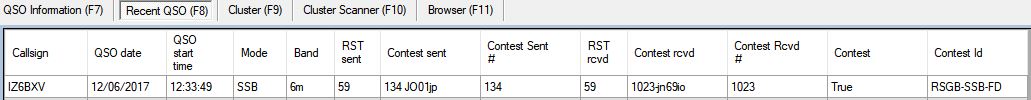

Which when saved results in the log entry shown below
And when that entry is exported as an ADIF file it contains the SRX and STX information shown below.
Don't forget to include the hyphen between the serial number received and the locator otherwise the number will not be parsed out to the SRX field in the ADIF file and log correctly - e.g. 1782(Hyphen)JO01jp (1782-jo01jp) ..... No spaces
