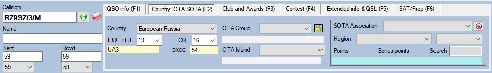

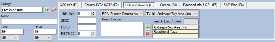

When L4OM populates the QSO info it says this station is from Asiatic Russia ITU20 CQ17 (not changeable)....but the RDA cannot be found in the awards dropdown for this region.
I then changed the region to European Russia ITU19 CQ16 (not changeable) and again the RDA was not in the dropdown.
So, my question is, how can we change the input to ensure we can capture the RDA when L4OM thinks the person is somewhere else?

Well it is there for me! have you updated the awards lately?HB9ETR wrote: 23 Jul 2017, 09:30I then changed the region to European Russia ITU19 CQ16 (not changeable) and again the RDA was not in the dropdown.

yes I have the updates set to auto but also did an individual update....and on both counts, I don't see the RDA in the dropdown
but I think I might have resolved my issue...
The original country for the station is Asiatic Russia and the RDA will therefore be incorrect.
Seeing as I couldn't find the RDA in the drop down, I saved the QSO then tried to amend (cx to Euro Russia) once saved.
It appears not possible to amend the RDA at this point (unless it was in the original dropdown of course). I can only see the correct RDA if I make the changes prior to saving the QSO.

You need to change the country to European Russia in the edit window, then save and exit the editor
Now when you go back into edit the full RDA list will be available
