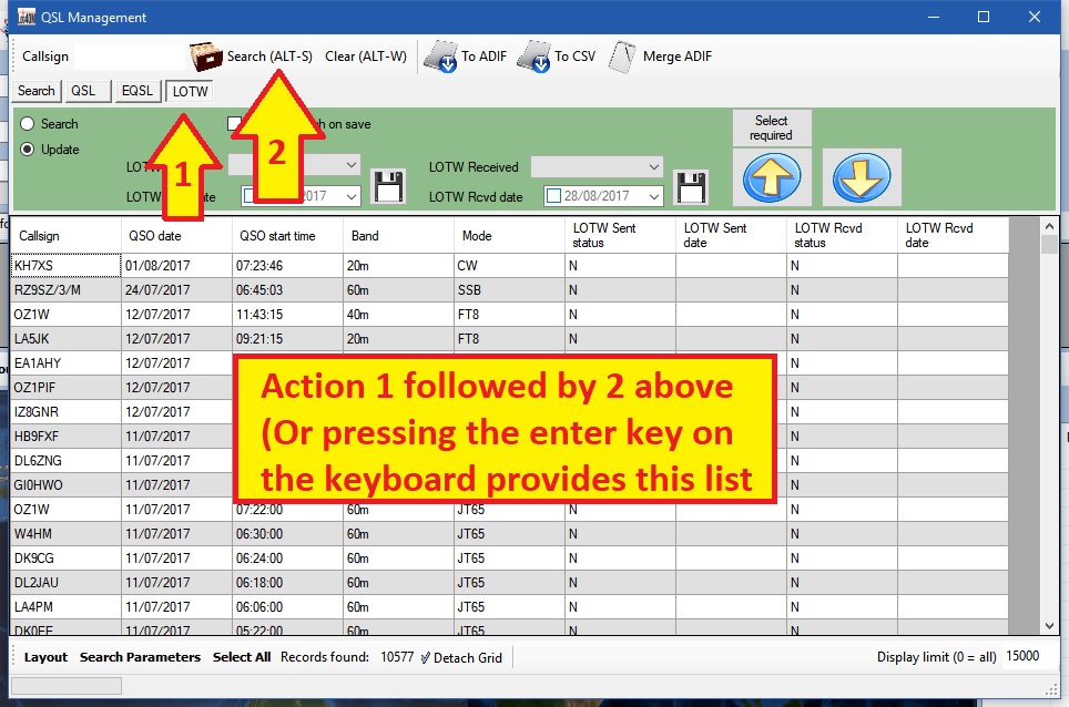

I have been looking at the help manual to learn how to upload QSO's to eQsl and LOTW.
The thing is, when I click on QSL management, none of the QSO's that I have logged appear in the window. So now I am stopped from going any farther. I read the pages starting with page 93. How do I get my QSO's to appear in the window to upload?
Ken K5XOM

You will see four buttons - Search - QSL - EQSL - LOTW - They are below the 'Call sign' input field and 'Search' button at the top left of the QSL manager window and just above the green coloured panel.
1. The 'Search' button enables you to enter a date range by checking the 'Date range' box and selecting the dates - If you don't check the box the next step will display all records or those for the call sign entered into the 'Call sign field.
2. If you now select any of the other three buttons you are presented with search facilities for that particular type of QSL you want to manage (QSL, EQSL or LOTW) as an example the QSL button provides facilities for searching or updating a record for incoming cards, whereas the EQSL and LOTW buttons provide upload and download facilities also
3. Entering a call sign at the top left 'Call sign' field and then either pressing the enter/return button on your keyboard or clicking the 'SEARCH' button next to the call sign field will display all of the QSO's for the call sign you entered.
4. If you leave the 'Call sign' field blank at the top left of the window and then either press the enter/return button on your keyboard or clicking the 'SEARCH' button next to the call sign field will display all of the QSO in your logbook.
We don't initially display every QSO in your logbook without some interaction from the user because in the case of large databases containing hundreds of thousand s of QSO's it can take a long time to display them - The idea is that you decide what you require and then only those QSO's are displayed.

Thank you Terry for providing those answers. A big help. Like hitting key board return without inserting a call sign, That is what I need to know to call up all qso's in the log.
thank you
Ken K5XOM
