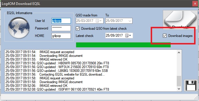

In the Log4OM 'Download eQSL' window have you clicked the 'Download images' box as below?
In the resulting download messages in the 'Download eQSL' window do you see messages like below?
25/09/2017 09:51:50: QSO updated : ER1PB 182100 20170906 20m FT8
25/09/2017 09:51:50: Contacting EQSL website for EQSL download...
25/09/2017 09:51:54: IMAGE request accepted
25/09/2017 09:51:54: Downloading IMAGE document
25/09/2017 09:51:55: IMAGE retrieved OK

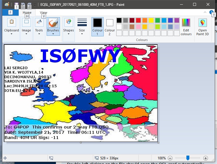

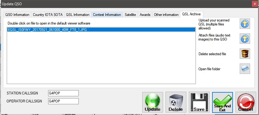

On QSO's that have received an eQSL confirmation when you double click the QSO to open the edit window do you see jpg files in the 'QSL Archive' tab as below?
Double left clicking on the file should open the QSL card automatically
