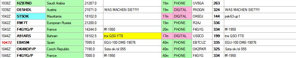

You can make a custom filter to do this .............
But it relies on the spotter adding the mode to the comments field
