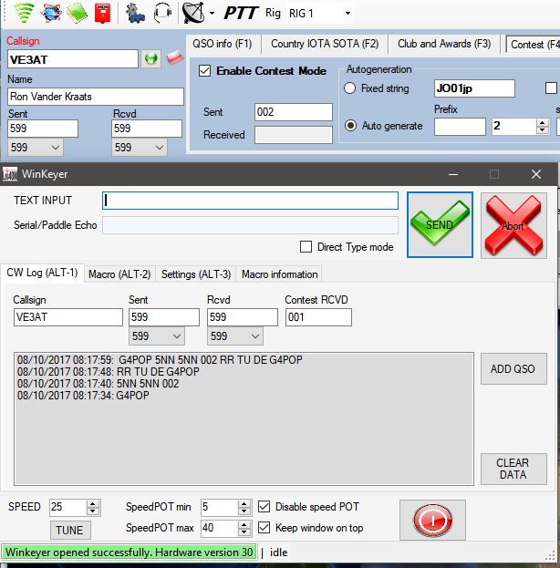

You have set Log4OM in contest mode haven't you? only as you can see below it works fine for me

Tnx Terry, yes with contest mode it works perfect :)
And of course this mode is mentioned in Winkeyer chapter of the manual, but I overlooked it, sorry.
