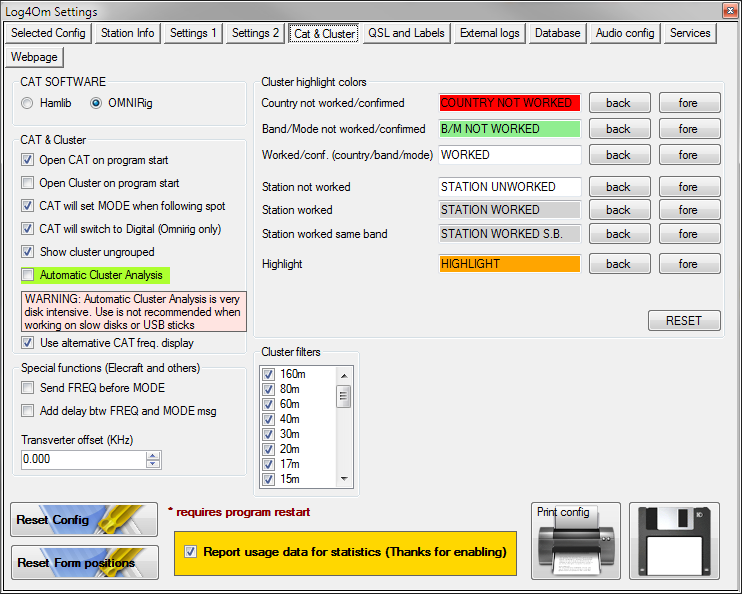

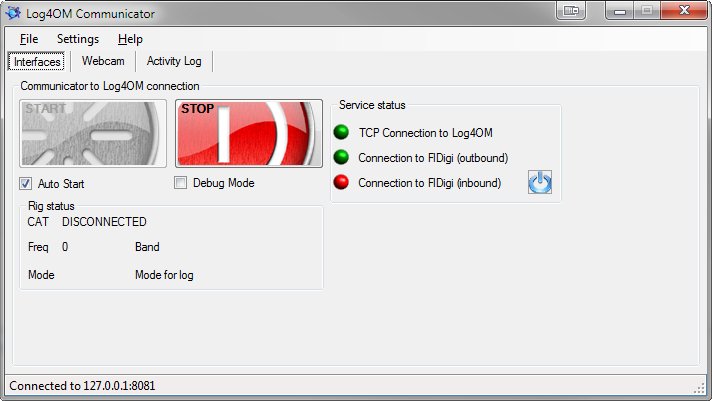

No matter what I do, I cannot get the CAT status light to get to green.
I do not use omnirig when using FLDigi as I do not use clusters so have not loaded omnirig in a while. I use an external interface (microHAM Digiikeyer II) and if omnirig and that hardware's program are loaded at the same time, my rig would key.
Now when I do want Omnirig to work, it won't.
The forum will not allow most of my searches, saying that the words I am using are too common. My rig is on com 4. Attached are screen shots of Log4OM settings, communicator setting and Omnirig.
I have been going around in circles for ages, for 3 hours (seriously!), to try to figure where I am going wrong.
Can anybody help?
73 de Guy G4DWV 4X1LT
Icom 7300 and cat control

Re: Icom 7300 and cat control
I think your issue is more to do with the Virtual Ports that the Digikeyer installs check the Microham user guide
I have found out what the issue is, and I am reporting back in case it helps anybody else. It was not due to any other software using the COM port. I used the OmniRig client test software to home in on this. The test program is very useful when checking on OmniRig issue and I would not have discovered the problem as quickly without it.
I had changed the "CI-V Transceive" setting to "on". All is well when the setting is changed back to "off".
So you had control over CAT off the radio, how was it supposed to work?
"CI-V Transceive" must be ON.
You have RTS and DTR High one should be low ...
