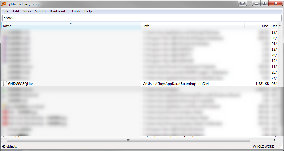

Where is the database located, its not on a network is it? -No I cant see the path from your images!
If so try copying the database to the computer Log4OM is installed on and see if it will then open
Re: Change database
The database is not on a separate computer. It is in its default location on the same computer as I have never moved it. It is here C:\Users\Guy\AppData\Roaming\LogOM.
Cheers
Guy
Cheers
Guy
