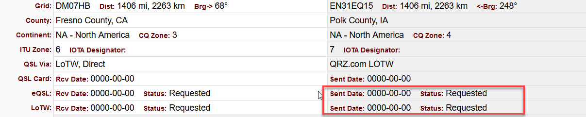

Is there something that needs configured for it to add the LOTW Sent date to QRZ?
My last 175 contacts look like this.
LOTW Sent requested

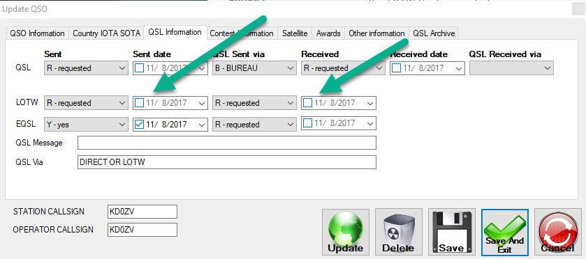

I just figured out that I can go in and check the boxes in the QSO (see below) and get the record to update on QRZ. Seems like Log4om should be doing this but I dont understand the handshake
I exported the ADI file after changing a few in Log4om and imported into QRZ and they changed.

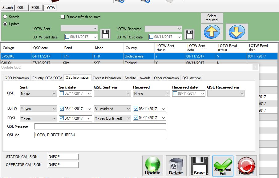

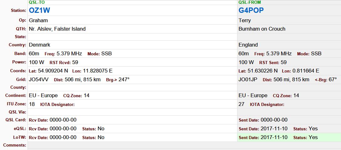

Well I just tested and here is the result - QSO uploaded to LOTW and verified by LOTW and this is reflected in the edit window for that QSO - All working and updating perfectly!
You can see the QSO in the top line of the QSL manager with dates and status is replicated in the edit window.

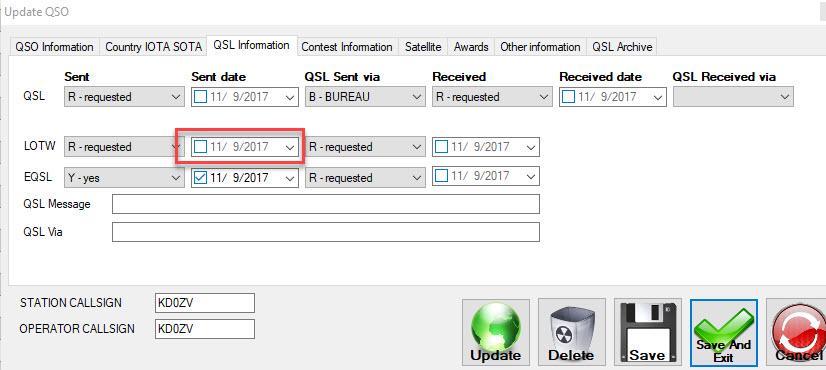

Here is what I think.
LOG4OM is not checking the LOTW requested box. As a test I unchecked the automatically upload to QRZ box. Made a contact. Went in and looked and this box for date is not checked.
If I check the date box and manually upload to QRZ then it shows up dated on QRZ.
One again, not sure how all this works but seems like LOTW should be checking the box before uploading.

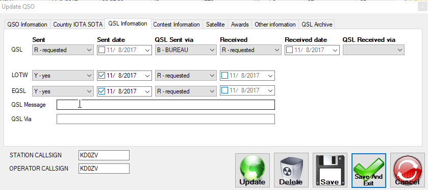

Thinking about it because the LOTW upload is manual and therefore done sometime after the QSO is logged, whereas the QRZ upload is done at the same instant that the QSO is logged then at the time of the QRZ upload nothing has yet happened re LOTW
On the basis of the above it is clear that the status of LOTW for that QSO could not be anything other that you are getting.
If however you disabled the auto upload to QRZ and then after having uploaded to LOTW manually went and uploaded to QRZ manually I am sure that the result would be what you require
I have just tried exactly what I described in paragraph 3 above and it all worked as expected.
