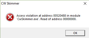

I cant seem to figure out what I am doing wrong getting CW Skimmer and log4OM working.
I can run them separately just fine but get an access violation when starting both. Doesn't matter which order I start them.
If I start the CW skimmer first then the radio (Flex 6500) does not talk to Log4OM, so I have been starting the logging program and then skimmer and ignoring the error to get it working.
CW Skimmer and Log4OM.
- 2017-12-31_9-47-33.jpg (16.4 KiB) Viewed 5292 times

You need to run CWSkimmer, Omnirig, Bandmaster and Log4OM 'As an administrator'

Its not and it does not matter if you don't have it installed I was just trying to demonstrate that all of those programs need to be set to 'RUN AS AN ADMINISTRATOR'kd0zv wrote: 01 Jan 2018, 20:34 Still have not figured this out and really dont understand what Bandmaster is contributing.
Omnirig provides a multi threading environment that allows CERTAIN software to all use it simultaneously to conect to one com port/radio!But appears the error comes from the fact that these programs are trying to launch its own instance of OmniRig??
What am I missing to allow the programs to all use OmniRig?
Quote from Afreet Software:
"Multi-threading: multiple programs, written by different authors in different languages, can control the radio via Omni-Rig at the same time"
These programs must be designed to do so and must each be 'RUN AS AN ADMINISTRATOR' to be able to all use Omnirig and synchronise!

I had a similar situation with Log4OM, Omnirig, WSJT-X and JTAlert. I'm using a 2 cable connection with an IC-7300. Log4OM has always been run as Administrator and I discovered that JTAlert/WSJT-X also had to be run as Administrator or CAT could not be shared between the two applications. Depending on how things were started up, CAT would work with one or the other but not both. Probably lots of folks have run into this.
What I conveniently discovered is if I have Log4OM launch JTAlert which in turn launches WSJT-X, everything ends up working correctly and I have assumed (that's a dangerous word!) that is because the launched programs must also by default be running as Administrator. The cool thing about doing it this way is there is no annoying UAC prompt when JTAlert or WSJT-X start up.
There may be a way to verify in the PC that these programs are running as Administrator. I don't know how to do that but it doesn't matter because it just works. I assume (there's that word again!) this method would work with other combinations of programs like Rich's situation.
EDIT - Ok, instead of being lazy, I googled how to tell if a program is running as Administrator and it is a very easy thing to do in Task Manager. A couple quick tests verify that indeed, all of the launched programs including Omnirig are all running "Elevated" (Microsoft's term) when launched by Log4OM running as Administrator. So, that eliminates the "assumed" a couple paragraphs above.
