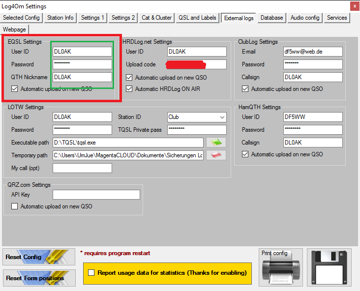

Hi Bill,
if the upload window is blanc and no messages in it it looks like Log4OM can´t
connect to the eQSL Server.
Did you check all the eQSL settings in Log4OM like password, QTH Nickname
e.g. ?
The password must be the same as for your login to the eQSL site and the
QTH Nickname must be the same as the Nickname in your Account on the
eQSL website.
Please no special characters in the password like $%§&/() e.g.
w2pky

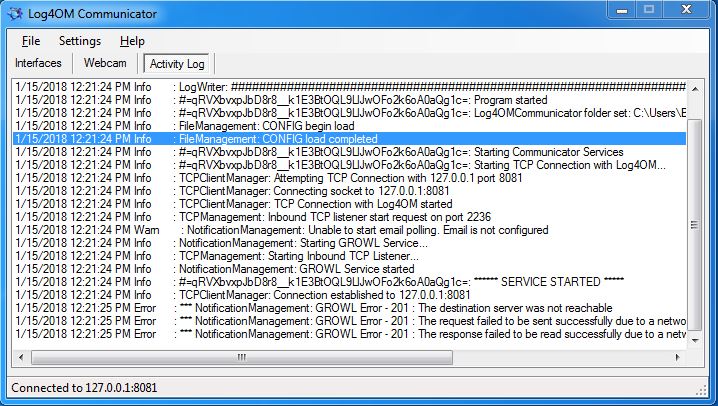

found some errors:
GROWL error 201;
What setting causes this?

w2pky wrote: 15 Jan 2018, 12:27 found some errors:
GROWL error 201;
The Growl error is because you either don't have Growl installed or set up for alerts, it's nothing to worry about
