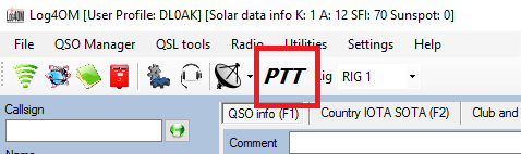

Hello Manuel,
did the PTT button in Log4OM working ?

Yes PTT button works. I am using omnirig for rig control. I am successful using omnirig and scu 17 interface in wsjt x without any problem.

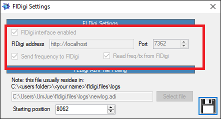

First we start with the Log4OM communicator. Did you have set in the communicator Settings/Inbound Settings/FlDigi
the following checkboxes, adress and port ?
If not you should stop the communicator with it´s STOP button, make your changes and start the communicator again.
After this close Log4OM and restart.
