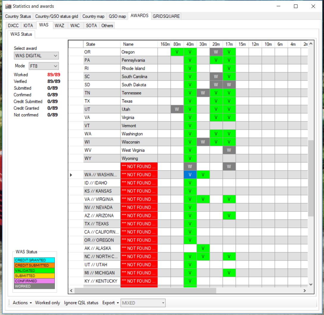

I have been helping another ham set up Log4OM. He had to reinstall his software including WSJT-X and JTAlert. We reinstalled his old sqlite file after reinstalling Lof4OM and everthing seemed to be working fine. He then recovered his WSJT-X adi file and then he started seeing his WAS award as 89 of 89 worked and confirmed. I looked at this award screen and it seems to have duplicate states. I have attached a screen shot. Anyone have any idea on how to fix this?
Bob AF9W

This is a known problem and will be resolved with the next release. Hold on for a bit. It's in Beta testing now.
Re: 89 of 89 States Confirmed Problem
Try redownload the full LOTW file from lotw update starting from 1900 (so you will re-parse all confirmations received). It should fix your issue.
Let me know

DC is valid for MD.

What does "Try redownload the full LOTW file from lotw update starting from 1900" mean? Is this done on the LOTW tab under QSL Management?
Bob AF9W
Yes ....
