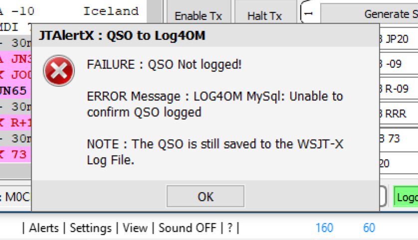

I am getting the same after updating to 1.31.1.0.
Screenshot 2018-02-17 12.26.52.png (125.71 KiB) Viewed 6536 times

It only happens randomly. Perhaps one out of ten. Sometimes it get into the log sometimes not.
Have been running Log4OM for ages but have noever seen this before the last update.

I am also having the same issue with the long delay in recording a qso from wsjt-x and JTAlert. It just started this morning and records as a failure to log, but does show up in recent qso in about 30+ seconds. I have checked the UDP ports in communicator and JTAlert and they are both set to 2236 and have reinstalled 1.31.1 as Administrator, but problem persists.
