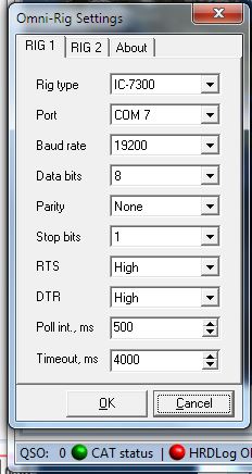

Like several others, I had problems getting my Icom 7300 to communicate with Log4OM. I now have it working, and I think I've figured out what was happening.
1. The baud rate must be at 19200 or slower. Even if a faster rate works with another program.
2. Sometimes but not always, after changing parameters, they still won't work until you turn the radio on and off, or close and re-open Log4OM, or both.
3. As Terry G4POP noted, both the LogOMUI.exe and OmniRig.exe programs should be set to Run this program as an Administrator (in [right click], Properties, Compatibility, Change Settings for all users).
4. OmniRig has a Client.exe program that can be used to test connectivity with the radio. It can be very useful troubleshooting. The Client is available at the DXAtlas site, in the OmniRig section. http://www.dxatlas.com/OmniRig/
I believe #1 and #2 above have to do with OmniRig. Trust me, I can use 115200 baud in another program to enable real-time screen display of the 7300's waterfall. But Log4OM won't talk to the radio until I slow things down to 19200 baud. The documentation for the OmniRig test client has some hints that the order you do things matters, hence the suggestion to cycle power to the radio and close and re-open the program.
