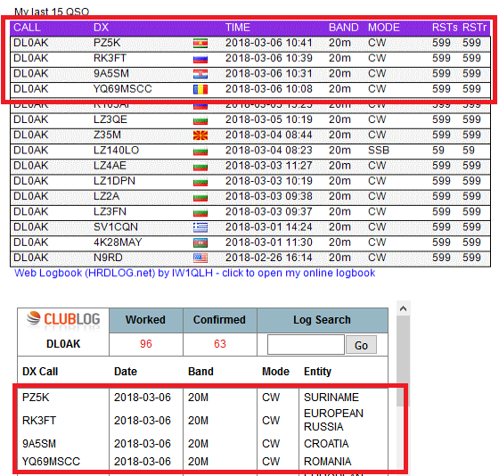

Hi Lele,
there was a problem in the last few day´s here too but this morning it´s back and it looks like that
uploads to CL are working. Using the "latest" RC2
(1.32.0).
