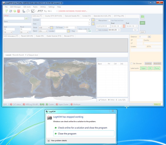

Guys
L4OM has decided to play silly with me.When I start itwill load communicator,but when it starts to load the database, it crashes with the attached screen
I also get the following reported as the error condition
Problem signature:
Problem Event Name: CLR20r3
Problem Signature 01: logomui.exe
Problem Signature 02: 1.31.1.0
Problem Signature 03: 5a6ed0ee
Problem Signature 04: System
Problem Signature 05: 4.0.0.0
Problem Signature 06: 53b51323
Problem Signature 07: 2362
Problem Signature 08: 8f
Problem Signature 09: System.AggregateException
OS Version: 6.1.7601.2.1.0.256.1
Locale ID: 2057
Additional Information 1: 4be7
Additional Information 2: 4be78fdd727e4350d8f2189583321f8d
Additional Information 3: f470
Additional Information 4: f4704197e60b106ca0548a70ae332ee8
Any ideas?? - running latest 1.31.1 W7 64 bit

Turns out the config.xml is totally corrupted, dont know how it happened, but having to start setting up from scratch...total pain in the ass
