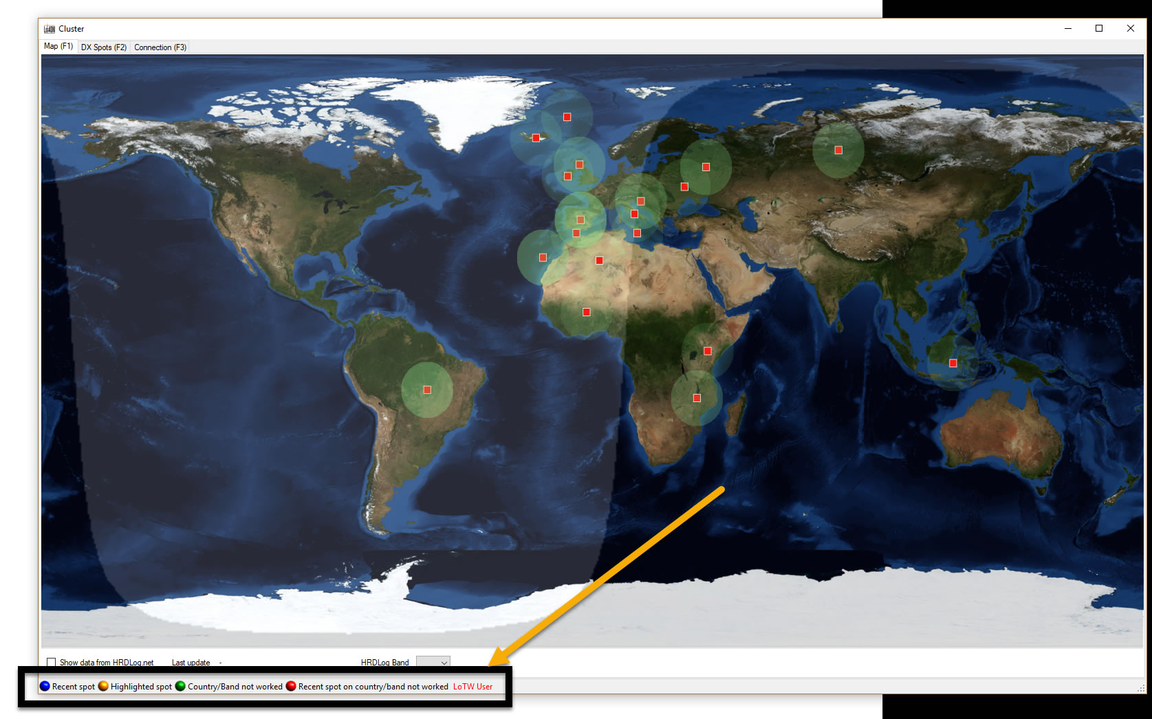

Also, does this stuff mean anything? Do not see where the colors apply to anything on the map or spot list.

Those colored balls on all the cluster and maps mean absolutely nothing. Ignore them. I've been trying to get them removed but it falls on deaf ears.

HRDLog.net just came online and it appears those colored circles do work.
However, the resolution and detail is so poor that there is no value in the great circle lines pointing out spots.
Is there any adjustment on this?

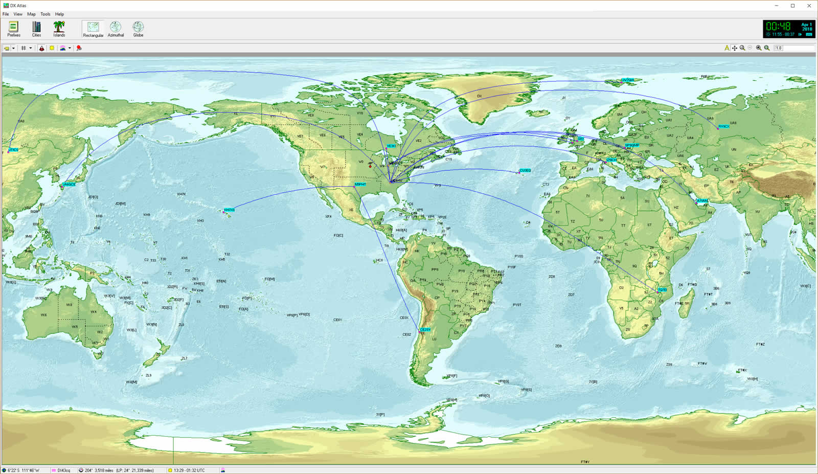

For comparison.
Log4OM
Bandmaster (spotters max 800 mile range)
