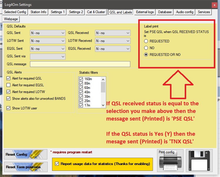

I think the Log4OM Options/QSL & Labels tab is self explanatory and that's why there are no detailed instructions in the user guide, I will however add some as below

Yes, now I understand the logic. Many thanks for your help in clarifying!
