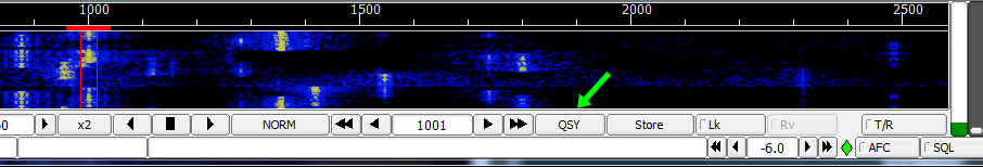

Fldigi has a very nice feature where you can click on a signal anywhere in the audio passband, and then click a "QSY" button. This retunes the radio so that the selected signal is now centered in sweet spot of the radio's passband, and moves the selection to that audio frequency. On my Icom 7300, this is 1500 Hz. Then one can narrow or widen the filter as needed, etc. So in the example below, if I clicked on the QSY button (green arrow), the radio would shift frequency so that the selected signal (in red) would move to 1500 Hz, and the selection would also jump to 1500. This is very fast and convenient, and avoids losing "lock" on the signal and dropping characters.
So it seems I can have Log4OM/Fldigi integration, or the "QSY to center" feature, but not both at the same time. Does anyone know if there's a way to make the QSY button work when Log4OM and fldigi are integrated?
Thanks and 73
--Peter, KD7MW
