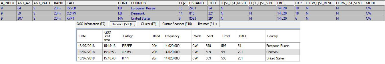

I have a problem with the backup. So far I've used the 1.32 version of the program. After the release of the new 1.33 version, I made a backup in 1.32 in the adif format and after loading the new program, it turned out that this adi backup is completely missing the mode in which I logged communications, i.e. CW and SSB. All my communication logs have been erroneously placed in the digi mode. I have never worked in this mode. Several thousand QSOs have been lost because of this. I am asking for information on how to run backups so that they do contain all of the information that I put in. I will be grateful for your help, the more that an even newer version of program 1.32.1 has appeared. I'm afraid that I will lose my logs again. I’m very much looking froward to your reply.

unfortunately, in the backup file there is no information about the mode in which I wrote qso.
I still have this problem. Now, after losing several thousand QSO, Irestore them with QSL cards, heavy and Sisyphean work.
I attach the backup file, please show me where is the information about the mode?

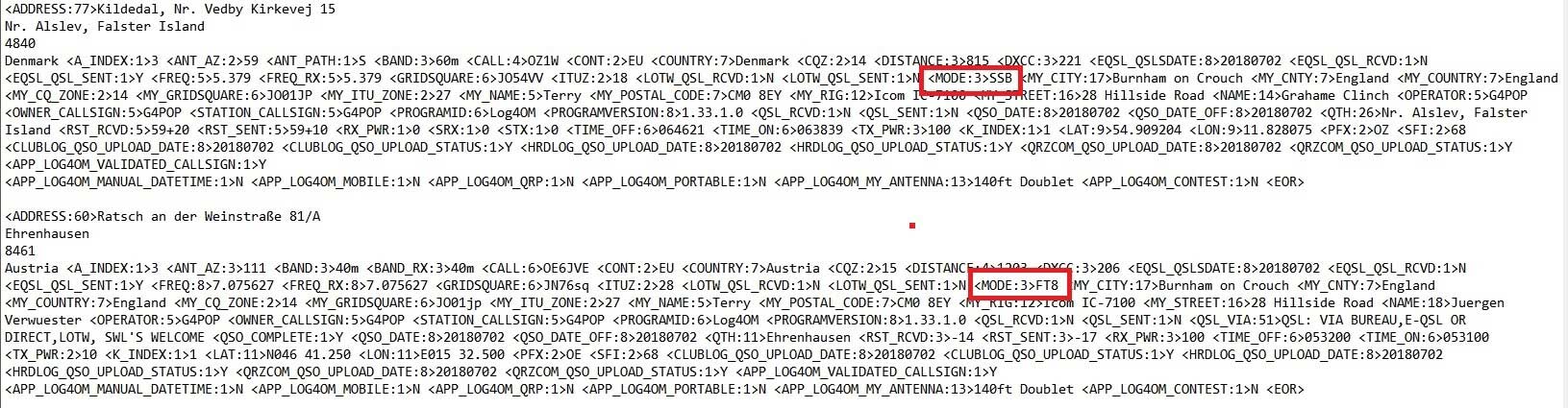

The adif file contains about 700++ QSO's were they all generated by WSJT/JTAlertJacek wrote: 16 Jul 2018, 07:02 unfortunately, in the backup file there is no information about the mode in which I wrote qso.
Best regards
Jacek SP8BAI
20180714162217_SP8BAI.zip
I checked my last backup ADIF file and there are modes recorded for every QSO, see below

Jacek wrote: 18 Jul 2018, 14:13I manually enter all QSOs from QSL cards. By manually writing QSO to the log, of course, I enter all the information about the QSO, also mode, ie CW or SSB.
When you enter the QSO manually with correct mode information and 'ADD' the QSO do you see the QSO does it appear in the recent QSO (F8) window with the correct mode?
When entering qso's without a radio connected for cat you should select 'Suspend CAT reading' in the settings menuAt the moment I do not have a connected TS590S, because I do not do QSO until I write in all QSOs. Usually, I works with a connected transceiver via CAT
I have just entered 3 QSO's without a CAT connection and they are displayed with correct mode in the Recent QSO window and the backup file generated when the program is closed included the correct mode - See below

"When you enter the QSO manually with correct mode information and 'ADD' the QSO do you see the QSO does it appear in the recent QSO (F8) window with the correct mode?"
Yes, after manually entering QSO from QSL cards, all information is included in the log, i.e. CW and SSB
today I connected the transceiver via CAT and I made QSO from the station from Ireland, also all essential detail is in the log. After taking the backup, there is still no information about the mode of operation in QSO, i.e. there is no CW, SSB FM etc.
