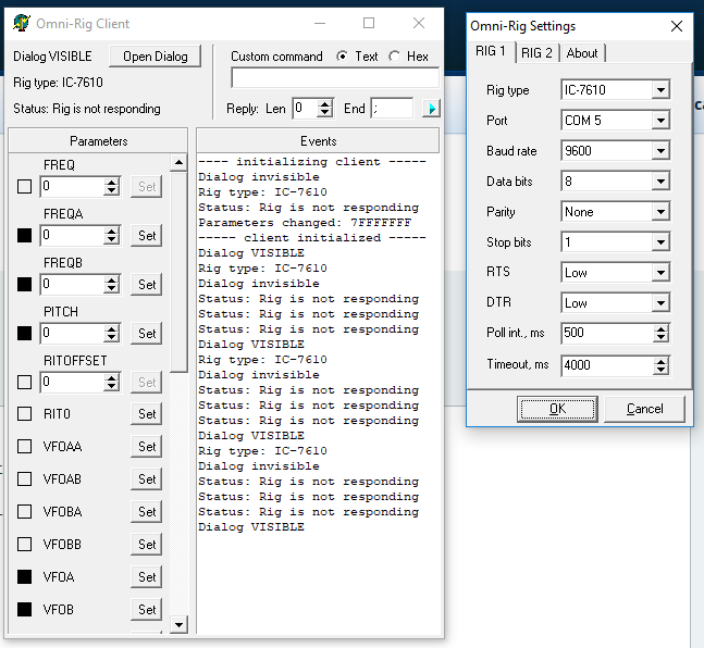

I have tried a lot to get Omnirig running and I can't. I've tried two different PC's and radio.
I've been using the Omnirig client to debug and this is what I get, no matter what settings.
The thing is other applications are working fine.

I wonder if you failed to install the genuine Icom USB drivers before connecting the radio to the computer?
If you did not then the normal Windows drivers would have auto installed and they wont work properly with the latest breed of Icom radios.
I know for a fact that we have several users that have 7610 and 7600 and the work fine with Omnirig.
Hamlib is usually a problem with Icom radios of all ages

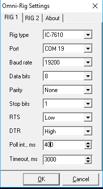

Here is my setup:
Icom 7610 setup
Go to: Menu -> Set -> Connectors -> CI-V
CI-V Baud Rate 19200
CI-V Transceive ON
CI-V USB Unlink From Remote
CI-V USB Baud Rate 115200

One thing to try. Apparently, if there is a chain of software that work together and one is running as admin, they all have to. Got this from the Omnirig programmer himself.
The other thing to try is to set the rig in whatever program you are trying to link to as "OmniRig Rig 1" if using the Rig 1 tab in Omnirig and NOT as IC-7610. Also, make sure that the baud rates all match. You WILL have probs if they do not.
These are things that I have learnt the hard way. I have an IC-7300 and use Omnirig with JTDX and Log4OM FB.
