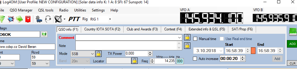

One more reply..
Seems it is reading the frequency...
Just the upper vfo displays doesnt show correct ones..
Please check the frequency on the downside of the screenshot..
it reads 14.235 correctly for vfo mode..
But display still showing sat mode frequencies.
- 2018-10-03_19-58-39.png (32.38 KiB) Viewed 3869 times
