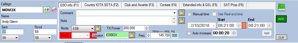

Here my screen shot.
73 - Rudi
Re: VHF Frequency - Out Of Band ???
Did you 'Suspend CAT control' from the settings menu?
