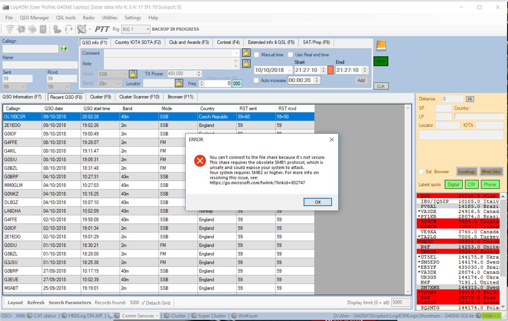

On my Windows 10 laptop, Log4OM loads files from my network, but when I try to close it down, I get a convoluted message about not being able to connect to the file share because it's not secure.
This share requires the obsolete SMB1 protocol which is unsafe................

The issue is with the secondary backup to my NAS. If I remove the secondary backup reference, all is OK.IW3HMH wrote: 10 Oct 2018, 16:20 Ciao Alain

All data from the database is loaded as usual and the primary backup is made on closure.
The main database is in a Dropbox folder which supplies my other PCs which have Log4OM installed.
The problem does appear to be a Windows issue, but right now I'm at a bit of a loss on how to cure it.
Here's a screenshot that you asked for:
- Log4OM.jpg (218.14 KiB) Viewed 7256 times
