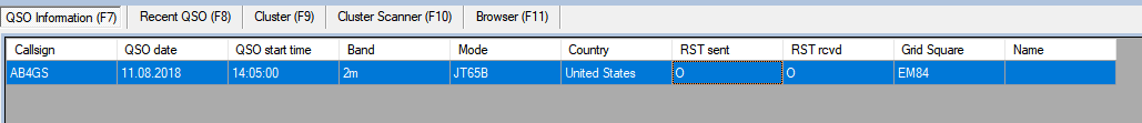

While importing LOTW confirmations from Log4OM
I noticed i was getting some errors as "not found" on my EME qsos.
I think, the mod that is kept on LOTW is JT65 instead of JT65B so, while downloading Log4OM can not find the qso information correct.
Maybe there should be something like JT65 = JT65B while downloading it from LOTW.

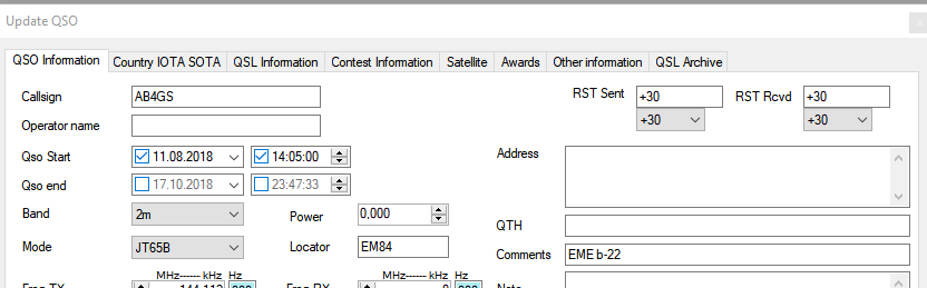

And second problem, on EME qsos the reports are not dB. Only "O" letter.
I can see it correct on my imported logs as "O" but on detail examination of the logs it seem like "+30"
I added the screenshot for it.
Regards

Re: EME qso errors on LOTW confirmation via Log4OM
Sorry for delay
About "O" you can edit the configuration file adding that value to the list.
More details in my post here:
http://forum.log4om.com/viewtopic.php?f=5&t=3601
About mode you can use the same way on file "modelist.csv" (copy, rename, etc) as before...
but: actual modes in modelist.csv says:
JT65;JT65;JT65
JT65A;JT65A;JT65A;JT65A
JT65B;JT65B;JT65B;JT65B
That means you can correctly receive a JT65 mode and Log4OM will use/mark it as JT65 correctly (in ADIF too)
so it's strange you cannot get the correct mode from LOTW download (provided you have saved mode as JT65 in your log) as Log4OM, matching LOTW, is strictly use mode and doesn't allow "guessing" or defaults as modes are not fully interchangeable (and grouping them in block with default mapping from LOTW is out of scope)
JT65;JT65;JT65
