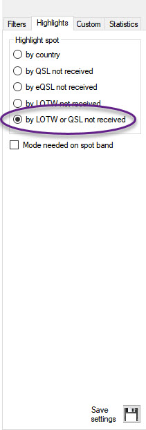

Is there any way to retain this setting (and others)?
I normally use the F9 cluster in the main window but also open the cluster and use removed worked countries so I have a warning that something is new.
So I have to go in and scroll through the tabs changing the settings on both cluster windows.
Just remembering the "By LOTW not received" would be a big help.

Did you try the 'Save settings' button at the bottom right - Looks like a floppy disk?
See the screen shot you posted - Works for me!

Oh geez.
I need to call in stupid today.
Thanks Terry.
