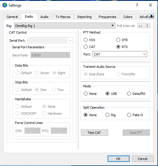

I Don't know if this will help, but this is a shot of the WSJT-X set up:

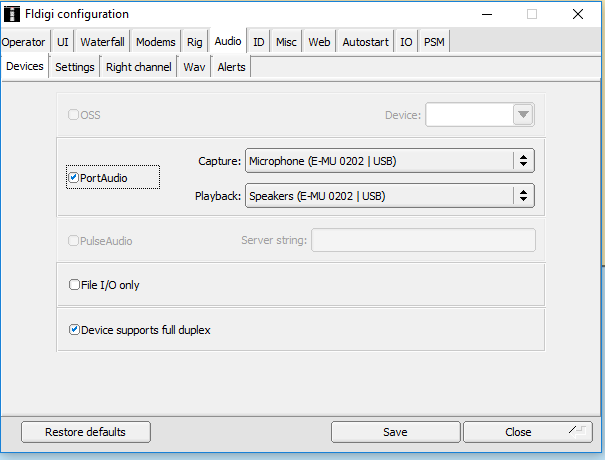

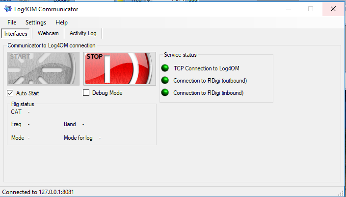

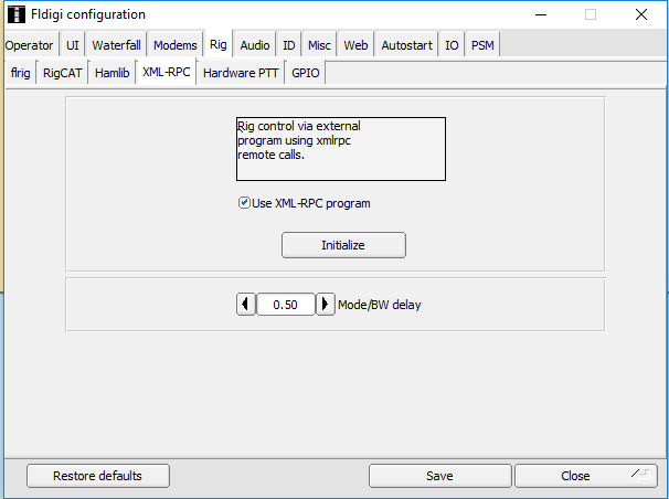

Show me the soundcard and rig configuration screens from fldigi

wd0dxd
Posts: 12
Joined: 19 Nov 2018, 03:37
Re: FlDIGI and TS-2000
Post by wd0dxd »
wd0dxd
Posts: 12
Post by wd0dxd »
wd0dxd
Posts: 12
Post by wd0dxd »
Let me know if you need anything else.
